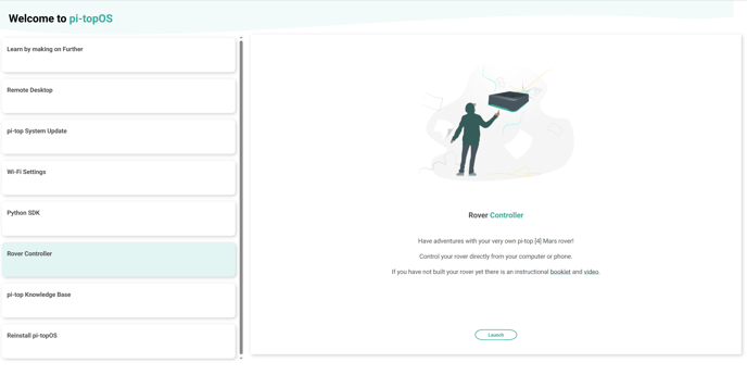

Finally, open a new tab in your web browser and enter the pi-top's IP address into the address bar, which should open a web page like the following:
Check out the various tools in the menu on the left side and use the buttons on the right to launch them.
Web Portal Pages
  • Learn by making on Further - Launch our online learning platform, Further. This is the place to get the most out of your pi-top, learn coding and much more!
  • Remote Desktop - Access the pi-top's desktop environment. Useful if you want to use desktop applications, advanced configuration or just use your pi-top like a regular computer. More info here.
  • pi-top System Update - Update your pi-top software. It's important to complete this when you first use your pi-top, after that it should handle updates by itself. More info here.
  • Wi-Fi Settings - Add new Wi-Fi connections to . More info here.
  • Python SDK - Access the technical documentation for the pi-top's Python programming SDK.
  • Rover Controller - Drive your pi-top around wirelessly! You will first need to build the Rover following this guide. More on this in Further.
  • pi-top Knowledge Base - Takes you right to this website, full of detailed guides about pi-top.
  • Reinstall pi-topOS - Instructions on how to reinstall the pi-top operating system software for a fresh, up-to-date start. More info here.
