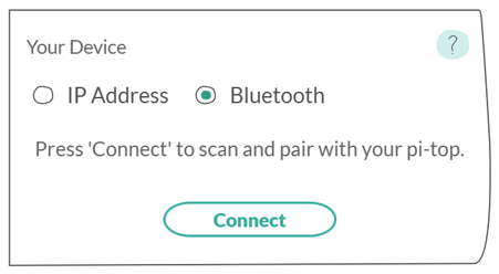

- Click the 'Bluetooth' toggle option and then the 'Connect' button
.png?width=451&height=249&name=image%20(75).png)
