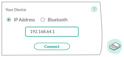

- Find your device's IP Address from the Miniscreen menu and enter it into the input in the connection box.
- Click 'Connect' and you're set! Runnable Python code on the page will have the Run button enabled.

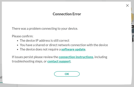

You may encounter a screen such as the one below when trying to connect to your device.
Try the troubleshooting steps below. If you're still having trouble, then get in touch with us at support@pi-top.com.

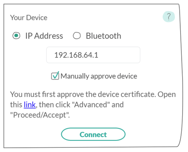

After you fail to connect, an additional checkbox will become available which gives you the option to 'Manually approve device'. This is a good workaround in some network environments where your computer can't automatically detect it is connecting to a secure local device. However, this does require dismissing browser security warnings and if you are not able to do this then there are alternative solutions below to be completed by your network IT admin..png?width=387&height=314&name=image%20(74).png)

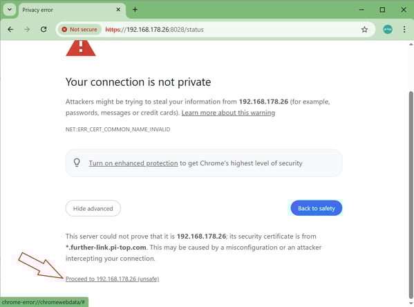

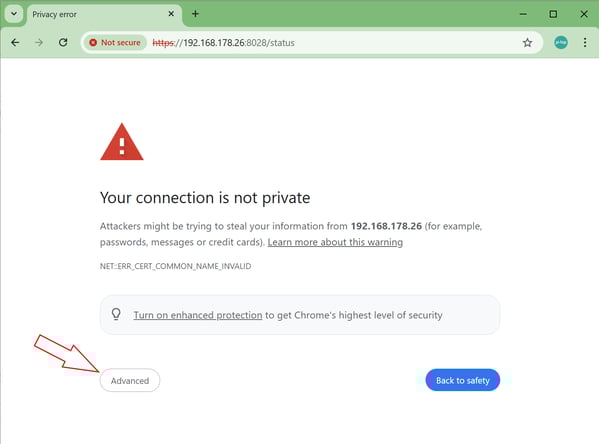

After checking this box the first time you will have to follow the link provided and tell your computer to trust the pi-top device. You will be taken to a browser approval page, which may look similar to the image below, and you will have to click the Advanced/Unsafe and Proceed options:

After clicking Proceed the page should say simple 'OK'. You can then close this tab and retry the connection in Further with the 'manually approve' box checked. Your Further page may be temporarily marked as 'Not secure' after using this manually approved connection.
If you don't see this approval page pleas try the Network Firewall solution below.
