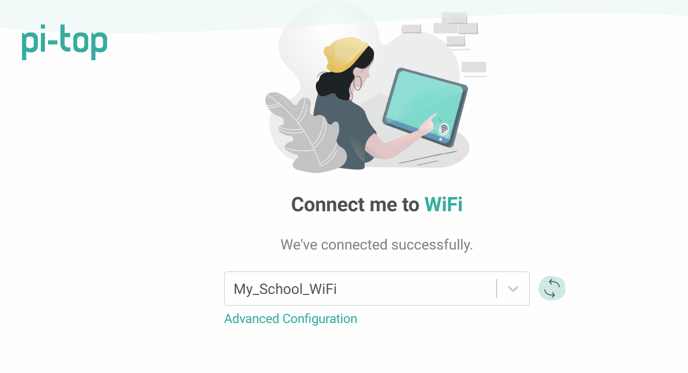

On the Wi-Fi Settings page (shown below), you can choose a network from the dropdown list and enter its password.
If your network uses advanced security settings, please refer to the 'Advanced Wi-Fi Configuration' section below.

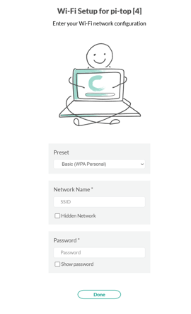

  2. Choose a 'Preset':
    In the form, select a preset that matches your network:
    • Basic – for networks using a simple shared password

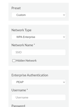

    • Custom – for more advanced configurations or a network-specific preset
  3. Enter your network details:
    Input your network’s SSID (you can scan it from another device to avoid typos), then continue to fill in the authentication information.
  4. For WPA2 Enterprise setups:
    If your network uses complex authentication (e.g., WPA2 Enterprise), consult your Network Administrator for the correct configuration parameters.

WPA2 Enterprise Configuration
Our configuration form supports a range of options for connecting to WPA2 Enterprise networks. This includes the ability to upload and install CA certificates on the device—useful for scenarios such as TLS inspection.
If you’re unsure about the required settings, please consult your Network Administrator for guidance.
